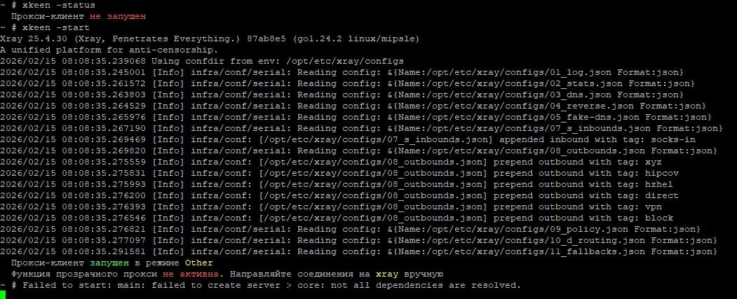

здравствуйте, установка прошла успешно, но не запускается:
/ # xkeen -start
  Предупреждение:
  Отсутствует политика «XKeen» в Web роутера
  Не определены целевые порты для XKeen
  Клиент xray будет запущен для всего устройства
Xray 1.8.4 (Xray, Penetrates Everything.) Custom (go1.21.0 linux/arm64)
A unified platform for anti-censorship.
2026/02/18 10:28:58 Using confdir from env: /opt/etc/xray/configs
2026/02/18 10:28:58 [Info] infra/conf/serial: Reading config: /opt/etc/xray/conf                                                                               igs/01_log.json
2026/02/18 10:28:58 [Info] infra/conf/serial: Reading config: /opt/etc/xray/conf                                                                               igs/02_transport.json
2026/02/18 10:28:58 [Info] infra/conf/serial: Reading config: /opt/etc/xray/conf                                                                               igs/03_inbounds.json
2026/02/18 10:28:58 [Info] infra/conf/serial: Reading config: /opt/etc/xray/conf                                                                               igs/04_outbounds.json
2026/02/18 10:28:58 [Info] infra/conf/serial: Reading config: /opt/etc/xray/conf                                                                               igs/05_routing.json
2026/02/18 10:28:58 [Info] infra/conf/serial: Reading config: /opt/etc/xray/conf                                                                               igs/06_policy.json
Failed to start: main: failed to load config files: [/opt/etc/xray/configs/01_lo                                                                               g.json /opt/etc/xray/configs/02_transport.json /opt/etc/xray/configs/03_inbounds                                                                               .json /opt/etc/xray/configs/04_outbounds.json /opt/etc/xray/configs/05_routing.j                                                                               son /opt/etc/xray/configs/06_policy.json] > infra/conf: Failed to build REALITY                                                                                config. > infra/conf: empty "publicKey"
2026/02/18 10:29:01 Using confdir from env: /opt/etc/xray/configs
2026/02/18 10:29:01 [Info] infra/conf/serial: Reading config: /opt/etc/xray/configs/01_log.json
2026/02/18 10:29:01 [Info] infra/conf/serial: Reading config: /opt/etc/xray/configs/02_transport.json
2026/02/18 10:29:01 [Info] infra/conf/serial: Reading config: /opt/etc/xray/configs/03_inbounds.json
2026/02/18 10:29:01 [Info] infra/conf/serial: Reading config: /opt/etc/xray/configs/04_outbounds.json
2026/02/18 10:29:01 [Info] infra/conf/serial: Reading config: /opt/etc/xray/configs/05_routing.json
2026/02/18 10:29:01 [Info] infra/conf/serial: Reading config: /opt/etc/xray/configs/06_policy.json
Failed to start: main: failed to load config files: [/opt/etc/xray/configs/01_log.json /opt/etc/xray/configs/02_transport.json /opt/etc/xray/configs/03_inbounds.json /opt/etc/xray/configs/04_outbounds.json /opt/etc/xray/configs/05_routing.json /opt/etc/xray/configs/06_policy.json] > infra/conf: Failed to build REALITY config. > infra/conf: empty "publicKey"
срочный вопрос - неделю на трех роутерах ставлю последние сборки, на ультрах, с последними конфигами с гит,
- ну при включении через xkeen зарубежные сайты не открываются, и даже подключение не семафорится...
xkeen сам устанавливает прокси соединение, или при vless ТАКИ НАДО СОЗДАТЬ в кинетике ПРОКСИ соединение руками? с соксами как в начале обсуждения, или какое? в мануалах последних никто ничего не создает... просто политику и все, и про ВПН или подключение приоритетное в мануалах НИЧЕГО! наверное в этом дело, что не работает с роутеров, а с телефонов все нормально...
43 минуты назад, theArhar сказал:
У Вас в самом конце сообщение об ошибке:
44 минуты назад, theArhar сказал:
empty "publicKey"
Не заполнено обязательное поле publicKey в outbounds для vless.
2026/02/22 16:20:47.678795 Using confdir from env: /opt/etc/xray/configs
2026/02/22 16:20:47.685157 [Info] infra/conf/serial: Reading config: &{Name:/opt/etc/xray/configs/01_log.json Format:json}
2026/02/22 16:20:47.710379 [Info] infra/conf/serial: Reading config: &{Name:/opt/etc/xray/configs/02_dns.json Format:json}
2026/02/22 16:20:47.711616 [Info] infra/conf/serial: Reading config: &{Name:/opt/etc/xray/configs/03_inbounds.json Format:json}
2026/02/22 16:20:47.714068 [Info] infra/conf: [/opt/etc/xray/configs/03_inbounds.json] appended inbound with tag: redirect
2026/02/22 16:20:47.714418 [Info] infra/conf: [/opt/etc/xray/configs/03_inbounds.json] appended inbound with tag: tproxy
2026/02/22 16:20:47.714752 [Info] infra/conf/serial: Reading config: &{Name:/opt/etc/xray/configs/04_outbounds.json Format:json}
2026/02/22 16:20:47.717869 [Info] infra/conf: [/opt/etc/xray/configs/04_outbounds.json] prepend outbound with tag: vless-reality
2026/02/22 16:20:47.718141 [Info] infra/conf: [/opt/etc/xray/configs/04_outbounds.json] prepend outbound with tag: direct
2026/02/22 16:20:47.718394 [Info] infra/conf: [/opt/etc/xray/configs/04_outbounds.json] prepend outbound with tag: block
2026/02/22 16:20:47.718683 [Info] infra/conf/serial: Reading config: &{Name:/opt/etc/xray/configs/05_routing.json Format:json}
2026/02/22 16:20:47.721550 [Info] infra/conf/serial: Reading config: &{Name:/opt/etc/xray/configs/06_policy.json Format:json}
2026/02/22 16:20:48.117429 [Warning] common/errors: The feature VLESS (with no Flow, etc.) is deprecated, not recommended for using and might be removed. Please migrate to VLESS with Flow & Seed as soon as possible.
  Прокси-клиент запущен в режиме Mixed

Переустанавливал:
~ # xkeen -uk
  Проверка доступности GitHub. Подождите, пожалуйста...
  GitHub доступен. Продолжаем...
  Проверка обновлений XKeen
  Нет доступных обновлений XKeen
~ # xkeen -k
  Переустановка XKeen
  Выберите вариант переустановки XKeen
     1. Загрузить дистрибутив XKeen из интернета
     0. Локальная переустановка XKeen
  Ваш выбор: 1
  Проверка доступности репозитория Entware. Подождите, пожалуйста...
  Репозиторий Entware доступен. Продолжаем...
  Выполняется загрузка XKeen
  XKeen успешно загружен
  Выполняется отмена регистрации предыдущей версии XKeen
  Успешно: Файл xkeen.list не найден в директории '/opt/lib/opkg/info/'
  Успешно: Файл xkeen.control не найден в директории '/opt/lib/opkg/info/'
  Успешно: Регистрация пакета xkeen не обнаружена в '/opt/lib/opkg/status'
  Выполняется регистрация новой версии XKeen
  Успешно: Файл xkeen.list найден в директории '/opt/lib/opkg/info/'
  Успешно: Файл xkeen.control найден в директории '/opt/lib/opkg/info/'
  Успешно: Запись XKeen найдена в '/opt/lib/opkg/status'
  Очистка временных файлов выполнена
  Переустановка XKeen выполнена
Изменено пользователем Lendy
добавил версию xkeen, логи
