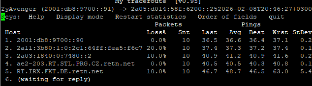

10 минут назад, avn сказал:
  Скрыть контент
interface Wireguard0
    description VDS
    security-level public
    ip address 172.16.97.91 255.255.255.240
    ip mtu 1420
    ip tcp adjust-mss pmtu
    ipv6 address 2001:db8:9700::91/64
    wireguard peer rRM3mJJ4
        endpoint ss.
        keepalive-interval 30
        allow-ips 0.0.0.0 0.0.0.0
        allow-ips 2000:: 3
        connect
    up
interface Wireguard2
    description ZyWARP
    ip address 172.16.0.2 255.255.255.255
    ip mtu 1420
    ipv6 address 2606:4700:569f/128
    wireguard peer bmXOC+F1FxEMF9dyiK2H5/1SUtzH0JuVo51h2wPfgyo= !CF
        endpoint engage.cloudflareclient.com:4500
        allow-ips 2000:: 3
        connect
    up
Через Warp CF nwg3
Через nwg0
Изменено пользователем avn
