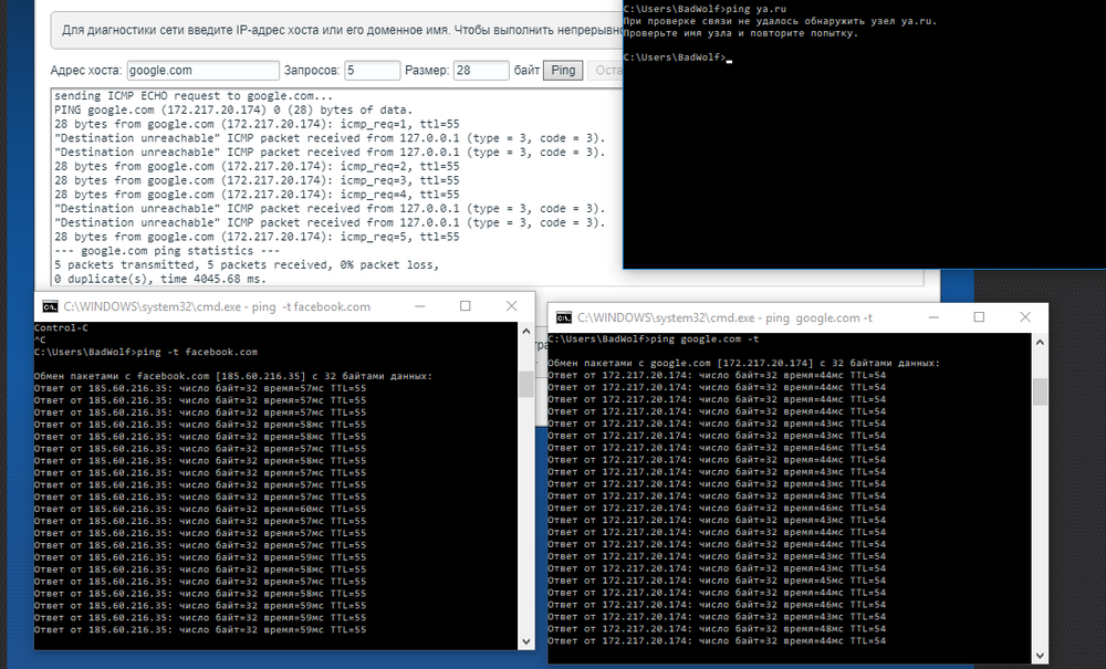

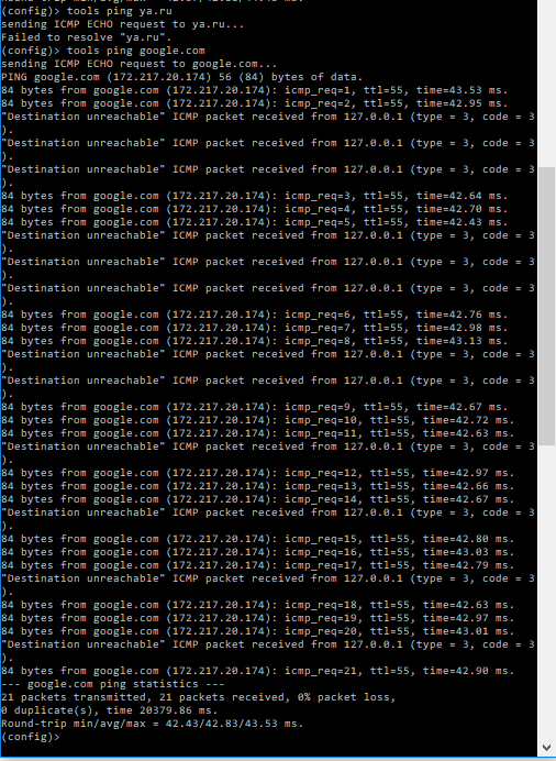

  12. 1 час назад, sergeyk сказал:
    Ну а остальные?
    (config)> tools ping google.com
    (config)> tools ping facebook.com
    Скрытый текст
    (config)> tools ping ya.ru
    sending ICMP ECHO request to ya.ru...
    Failed to resolve "ya.ru".
    sending ICMP ECHO request to google.com...
    PING google.com (172.217.20.174) 56 (84) bytes of data.
    84 bytes from google.com (172.217.20.174): icmp_req=1, ttl=55, time=43.00 ms.
    84 bytes from google.com (172.217.20.174): icmp_req=2, ttl=55, time=42.80 ms.
    84 bytes from google.com (172.217.20.174): icmp_req=3, ttl=55, time=43.03 ms.
    "Destination unreachable" ICMP packet received from 127.0.0.1 (type = 3, code = 3
    84 bytes from google.com (172.217.20.174): icmp_req=4, ttl=55, time=42.94 ms.
    84 bytes from google.com (172.217.20.174): icmp_req=5, ttl=55, time=42.21 ms.
    84 bytes from google.com (172.217.20.174): icmp_req=6, ttl=55, time=42.76 ms.
    84 bytes from google.com (172.217.20.174): icmp_req=7, ttl=55, time=42.64 ms.
    --- google.com ping statistics ---
    7 packets transmitted, 7 packets received, 0% packet loss,
    0 duplicate(s), time 6644.77 ms.
    Round-trip min/avg/max = 42.21/42.76/43.03 ms.

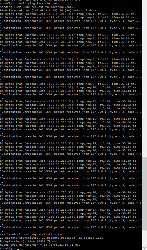

    sending ICMP ECHO request to facebook.com...
    PING facebook.com (185.60.216.35) 56 (84) bytes of data.
    84 bytes from facebook.com (185.60.216.35): icmp_req=1, ttl=56, time=57.12 ms.
    84 bytes from facebook.com (185.60.216.35): icmp_req=2, ttl=56, time=56.11 ms.
    84 bytes from facebook.com (185.60.216.35): icmp_req=3, ttl=56, time=56.04 ms.
    84 bytes from facebook.com (185.60.216.35): icmp_req=4, ttl=56, time=55.80 ms.
    84 bytes from facebook.com (185.60.216.35): icmp_req=5, ttl=56, time=56.42 ms.
    84 bytes from facebook.com (185.60.216.35): icmp_req=6, ttl=56, time=56.50 ms.
    84 bytes from facebook.com (185.60.216.35): icmp_req=7, ttl=56, time=56.24 ms.
    --- facebook.com ping statistics ---
    8 packets transmitted, 7 packets received, 12% packet loss,
    0 duplicate(s), time 7042.11 ms.
    Round-trip min/avg/max = 55.80/56.31/57.12 ms.

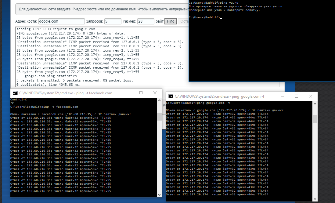

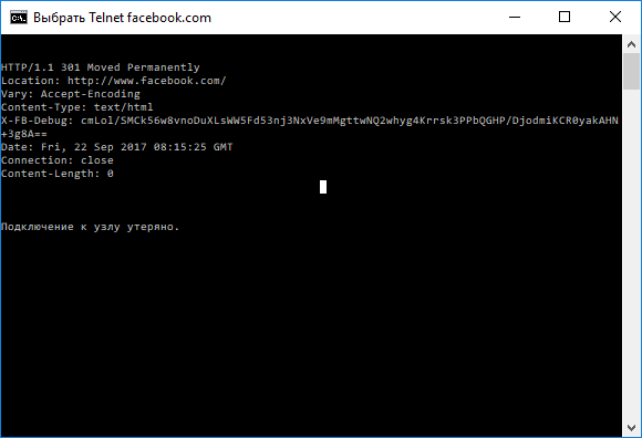

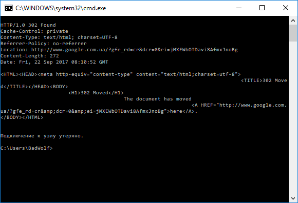

  13. 16 минут назад, sergeyk сказал:
    EasyConfig проверяет доступность сайта, подключаясь к его 80 порту по TCP.
    Ну браузером то я захожу на гугл и фейсбук без проблем.
    хорошо, делаем telnet google.com 80 и передаем команду GET /
    получаем
    ну и для facebook.com 80 получаем
  14. Что-то все же работает не так
    вот что выдает проверка через cli
              checked: Fri Sep 22 10:04:57 2017
             reliable: yes
    gateway-accessible: yes
       dns-accessible: no
      host-accessible: no
             internet: no
              gateway:
                interface: PPPoE0
                  address: 0.0.0.0
                 failures: 0
               accessible: yes
                 excluded: no
                hosts:
                     host:
                     failures: 0
                     resolved: no
                   accessible: no
                     host:
                     failures: 0
                     resolved: no
                   accessible: no
                     host:
                     failures: 0
                     resolved: no
                   accessible: no
    а вот проверка пингами сайтов (если что на хосте как днс используется только адрес роутера)
    Скрытый текст

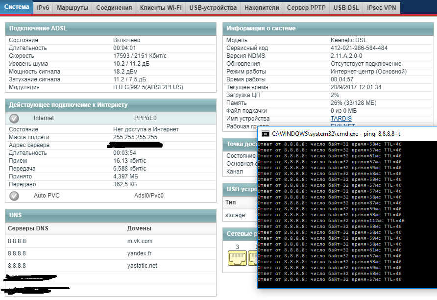

    22 часа назад, Mamay сказал:
    Ну ладно, фиг с ним с Яндексом, но Google и FaceBook тоже ваш президент залочил? :facepalm:
    Залочены в основном сайты Яндекса и Mail RU Group. В основном по ip+dns, некоторые провайдеры прогнулись и залочили и сайты не указанные явно в списке этих же контор, но только по днс - так у меня прописано
    8.8.8.8    yandex.fr
    8.8.8.8    yastatic.net
    и я смотрю погоду на yandex.fr :)

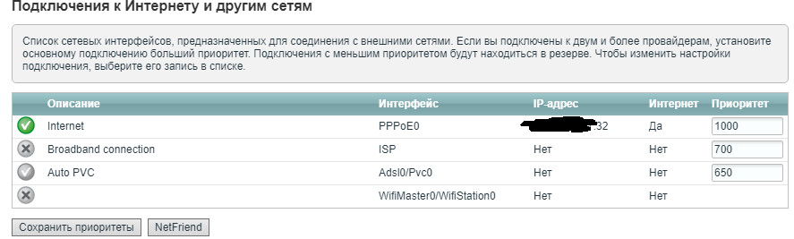

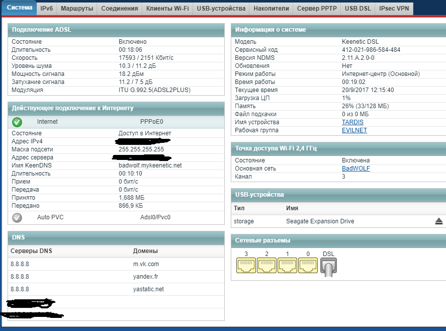

  15. Доброго времени суток!
    Keenetic DSL, Версия NDMS    2.11.A.2.0-0
    При входе на главную страницу состояния секунды 2-3 в состоянии подключения показывает "Доступ в Интернет", затем состояние меняется на "Нет доступа в Интернет". Так стоит пока не уйти со страницы - если перейти на любую вкладку веб-интерфейса и вернутся на главную страницу состояния, то снова несколько секунд будет показывать, что интернет есть, затем "Нет доступа в Интернет". Реально доступ в интернет при этом не пропадает, т.е. по факту всё работает, только статус доступа в Интернет определяет неправильно.
    В журнале при этом красных записей нет. И когда статус меняется на "Нет доступа в Интернет", то в веб интерфейсе перестает отображать ip адрес, назначаемый провайдером. Скрин приложил с пингами наружу, чтоб было видно, что реально Интернет есть
    self-test.txt
    Скрытый текст
